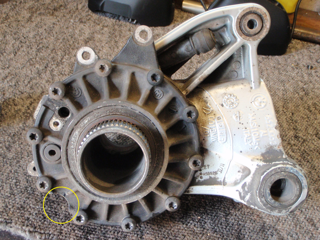

2. Whoever designed the rear disc and carrier fitment forgot to leave enough space to get the torx bit in. The final drive hub gets on the way. :( Any tips?
2/ there’s a spot where it’s possible to get the bit in. Turn the wheel till it lines up. JJH
1 You might have to provide clearance for the pads to clear the disc by pushing the pistons back into the caliper body, you should be able to do this by pushing on the outside of the caliper body by strong hand force - push the caliper toward the wheel where it will move on the sliding pins. It`ll be best to do this with the caliper bolts replaced and snug.
2 BMW have provided access to the disc retaining bolts via the cut-out in the final drive housing where your torx driver will go - see pic. You can do one bolt at a time..

Thanks all. I tried it and I'm bound to say that cut out is a tight fit for the torx but we'll give it a go! :thumb2
Just for anyone else doing this job, here's the carrier for the disc and the wheel. I was wrong.- it carries both the wheel and the brake disc. It does seem relatively flimsy to carry all that weight and stresses! :eek:
And here's the cut out in the final drive. It's really not big enough and you end up with the torx bit (a long one) at a slight angle. There's also the risk of damaging the coating on the FD. Hence the masking tape to protect it.
Not the first time I've cursed BMW design engineers. :(
However, I managed ok and torqued it up to 30nm per bolt.
