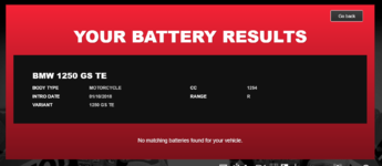

Out of curiosity I thought I'd give the Yuasa site a go and it doesn't show one for the 1250.
