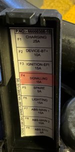

On my run down to the Chunnel on the M20, I noticed that all the instrument cluster was dead, along with the horn, fuel gauge, time, speed, rev counter and turn indicators. In short, nothing was working or displayed. The bike though was running normally.
The 15 amp fuse F4 ‘signalling’ had blown.
I can restart the bike sometimes with the fuse blown, with the bike in neutral but only with the clutch lever pulled in. I guess this is because the starter is not receiving a ‘neutral’ signal as the instrument cluster is dead?
I changed the F4 fuse, the instrument cluster lit up as normal. I rode about 10 yards and the instrument cluster failed again, due to the F4 fuse blowing again.
I changed the fuse again, with the same result. Within 10 yards it blew again.
I did though notice that over the 10 yards before the fuse blew, the orange engine warning light stayed on.
I have checked as much of the wiring as I can see up at the headstock end. I cannot see any chafed wires.
Something is shorting, the fuse blowing as a consequence. I cannot understand what though. Nor can I understand why the orange engine warning light seems to stay on. I am guessing that this might be linked or not? What in the engine management system might cause the instrument / horn / turn indicator fuse to blow?

Hello Richard
I had Quick Look at the diagram on internet and without an insulation tester the only way is to if possible remove each item in the circuit .That is until the fuse stays good .

Looking at the cct diagram the front and rear stop lamp switches and the actual stop lamp itself are on this fuse that would be my first port of investigation

on F4 fuse you have the wheels speed sensor and rear stop lamp and switches front and rear.
I would first look at the rear stop lamp and associated switches.
Temporary isolation of each and see how you go?

Thanks for the replies. The problem is mended.
We noticed that the horn had vibrated loose on its mounting, swinging down to just touch the exhaust header pipe, sufficient to slightly melt the plastic covering of its connector and cause a short.
From most angles, it all looked normal. This accounted for why, when the bike was stationary with the ignition on and the engine running, the F4 fuse wouldn’t blow. Riding just a few yards, was sufficient to move it slightly and earth, with the inevitable blowing of the fuse.
That just left the orange engine warning light, which wouldn’t clear. I knew that there was nothing wrong with the bike per-se, so I just rode with it on. After about 90 minutes, we stopped for fuel. On restart, the orange light cured itself and switched off. It has not appeared since.
I realise now that this was self inflicted.
When I fitted the new down pipe, I slackened off the horn, to move it out of the way. Having fitted the exhaust, I moved the horn back but just nipped it up, while I had a quick test ride, intending to tighten it up, when I came back. Intention was one thing, actually doing it was quite another.
