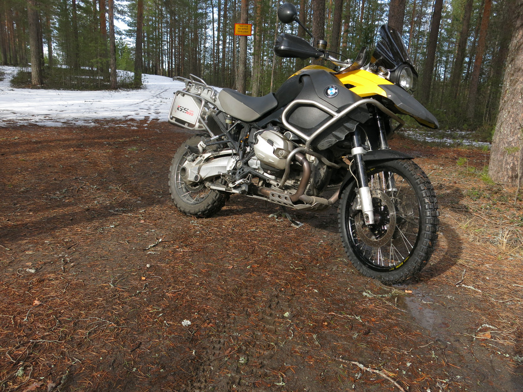

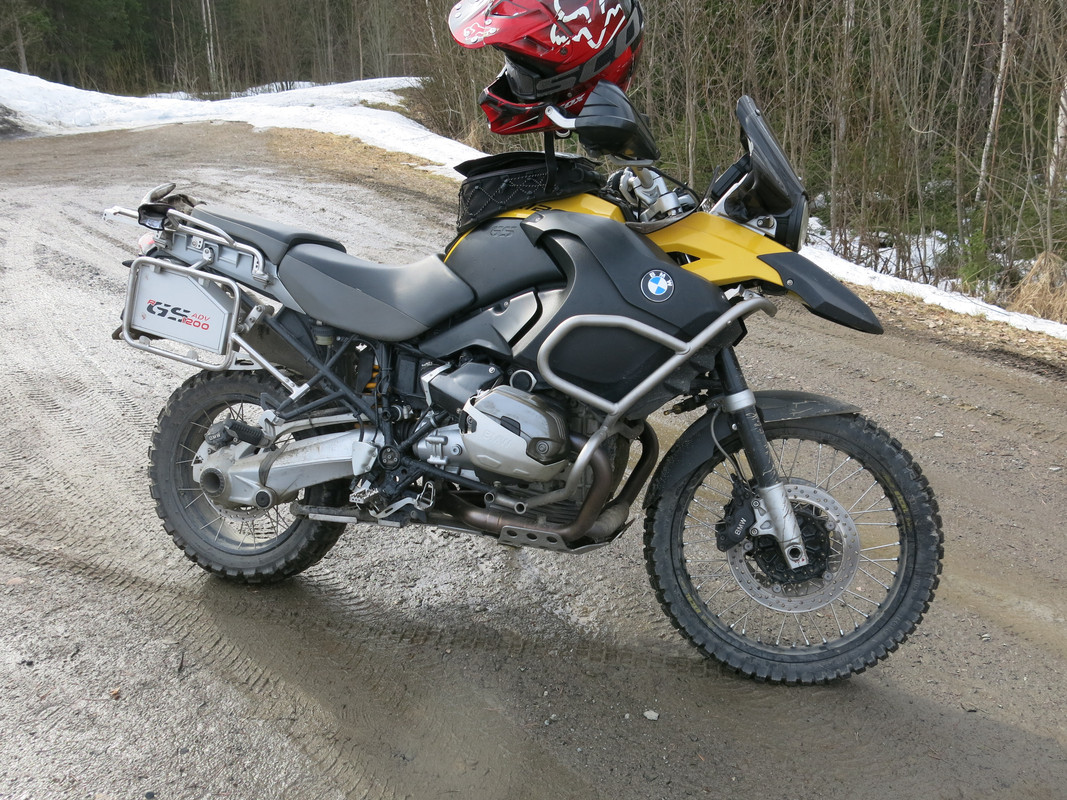

A very good idea to build the 21" wheel with parts from HP2Enduro. I have tried to get hold of such a rim but have not succeeded. I chose instead to build my wheel with an Exel rim and special spokes intended for a standard hub. I bought the parts from wheelsandparts.se and built the wheel with a used original BMW K25 hub from ebay. My bike has Öhlins EC shock absorbers and I have the lower recommended preload in the front but I have not changed the height of the rear suspension. With the larger front wheel the front trail is increased a bit and the bike also gets a slightly flatter steering angle. I see both of these changes as an improvement when riding on loose roads. The bike feels much nicer with 21” wheel, I don't miss my R100GS as much now! The rim measures 1.85" x 21" and I have a TKC80 tire, 90/90-21. Although it might be somewhat less stable at high speed on an asphalt road it doesn't matter to me. I ride dirt roads / gravel roads and trails with my GSA and own better motorcycles if I like to ride highways at high speed.
Since the radius of the new 21" wheel is about 20mm larger, there will not be much clearance between the stock front fender and the tire. There are a few different ways to solve this and many people simply choose to ride without a front fender. I rebuild my fender by cutting a hole where it touched the lower fork bridge and making new brackets, I have moved the fender up about 15mm which seems to be enough. If I have problems with the wheel getting stuck in the fender when I ride in mud, I will probably try to ride without a fender. We will see how i works when spring arrives here in northern Sweden

My motorcycle does not have traction control but it does have ABS and it was not affected by the change to 21" wheel. With the reservation that I have only ridden a few short rides, it seems that nothing on my bike is affected by the wheel change. No warning lights and everything works as before. Of course I always turn off ABS when I ride off-road, otherwise you have no rear brake! I was also thinking of building with a spoke wheel rim but since these are hard to get hold of so that didn't happen. An R100GS rim would have worked but they are expensive or in poor condition. I couldn't get hold of any HP2 Enduro rims so I chose Exel. The company wheelsandparts.se had everything I needed and at a reasonable price. So I ride with tubetype tire up front. My bike doesn't have TPMS so I didn't need to think about it. I will ride with the stock 17" rear rim because I think it will provide well working geometry. Now my bike has slightly less than 120mm trail and maybe a degree more steering angle (or "headrace" angle) which is then about 26 degrees. If you compare it to an HP2E it is stated to have as much as 127mm trail and 30 degrees steering angle and also a significantly longer wheelbase. So my R1200GSA is still a "more nervous bike" in terms of geometry compered to a HP2E but that may be needed when it is much heavier. So I think my conversion to 21" wheel will work well!
I've now ridden about 100km with my new 21" front wheel and I'm very happy with how the bike performs.
It's more stable on gravel roads, the front wheel doesn't have as much of a tendency to dive on sandy roads and on asphalt it feels about the same as before.
The slower geometry feels like an advantage in all situations and the larger and narrower front wheel seems to be exactly what I prefer.

I am also very happy with my conversion to 21" front wheel. I have now ridden about 500km (cold spring here in northern Sweden so no long trip so far) and can safely say that it works. The ABS has exactly the same function when I use the bike for everyday riding. I have tried to provoke the ABS to intervene on all surfaces I have ridden and it works the same way as with the original wheel.
When riding active on loose surfaces I always switch off the ABS.
As I see it, the big differences are that the wheel is narrower and 21” (obviously) and that it also gives the front increased trail. I see the change in weight distribution as very small with only 20mm of front lift and I have tried raising the rear end to compensate but prefer standard.
The increased trail is an advantage and makes my bike better in my opinion.
The narrower front wheel with a coarse pattern (TKC 80) has significantly less rubber in the asphalt compered to at street tire so the maximum cornering speed on asphalt is lower and the braking distance is longer.
At high speed it is not as stable but I don't use my GSA for that.
On gravel roads it is fantastically much more fun and on terrain the difference is very big, it now feels like a offroad bike! (a heavy and big offroad bike!)
Definitely a modification I recommend to everyone who rides terrain, trails and gravel roads with their GS(A) K25.
If anyone is thinking of converting to a 21" front wheel and mounting a road tire, I wonder why they would do that?
Thanks to the narrow 1.85" front rim, I can ride with a 90/90 21" offroad tire, which makes the bike much more pleasant on the side of the road. The stock 19" wide front wheel is not great when driving over old wheel tracks in the dirt and then you have to be prepared so that the bike doesn't find the wrong track. With the narrow 21" wheel, the bike is much easier to ride, it now does what I want even when I pass old deep wheel tracks.
The larger wheel also makes the bike more pleasant in city traffic when you must drive very slow (almost zero km/h) and don't want to put your foot down. The balance is better with a large wheel and more trail.
My bike doesn't have traction control so I can't say for sure that it isn't affected. As I see it, it doesn't matter that much. If you're considering 21" front wheel, you're doing it for use at off-road/bad roads and then you turn off TC anyway.
