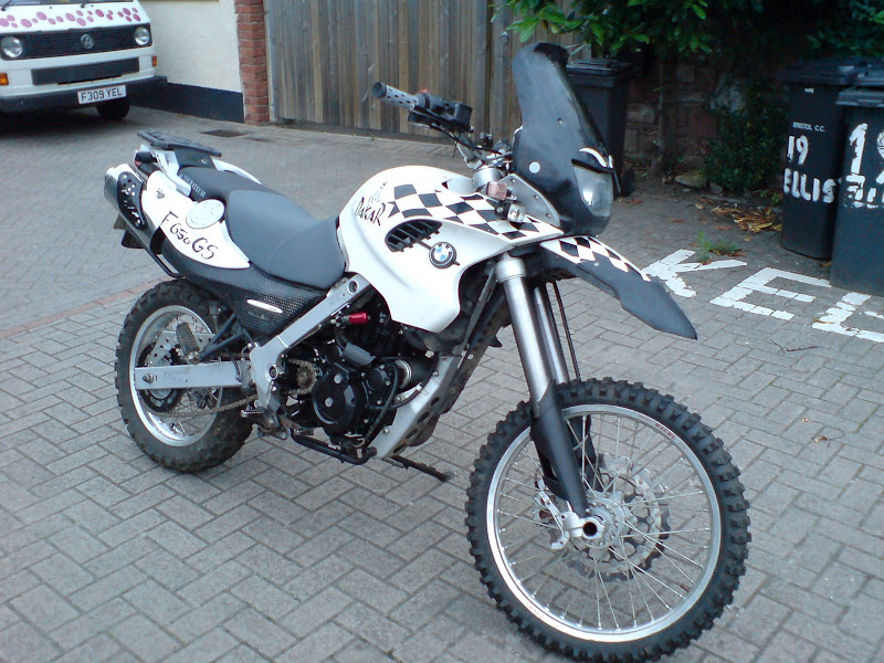

lets see some Pics of this modified Dakar then If I cant sell mine I may just look at some modding bits
Ask and ye shall recieve :thumb
You'll be lucky to get hold of the rear swing arm though :augie:augie:augie

WP KTM front forks with Touratech yokes and ignition barrel holder
Renthal Fat bars
Acerbis supermoto mudguard
BMW F650 hubs laced with heavy duty stainless spokes onto Excel rims
Ex works Schalber rear swing arm with longer WP rear shock
TT pannier frames
Supertrapp titanium exhaust (now replaced with standard one as it was too noisey for me.
TT rallye footrests and hangers (incl gear lever and brake lever).
I think that covers it.
As for building a similar one, you'd better sell ya 800 or have a very keen eye for the parts on ebay. Thankfully a very good friend of mine has the latter and sourced all the parts for his own project. Unfortunately he didn't use the parts, so he sold them to me.
Brand new i reckon you'd be looking at 3+k for the parts to do the job (without the swing arm as they are not available anymore).

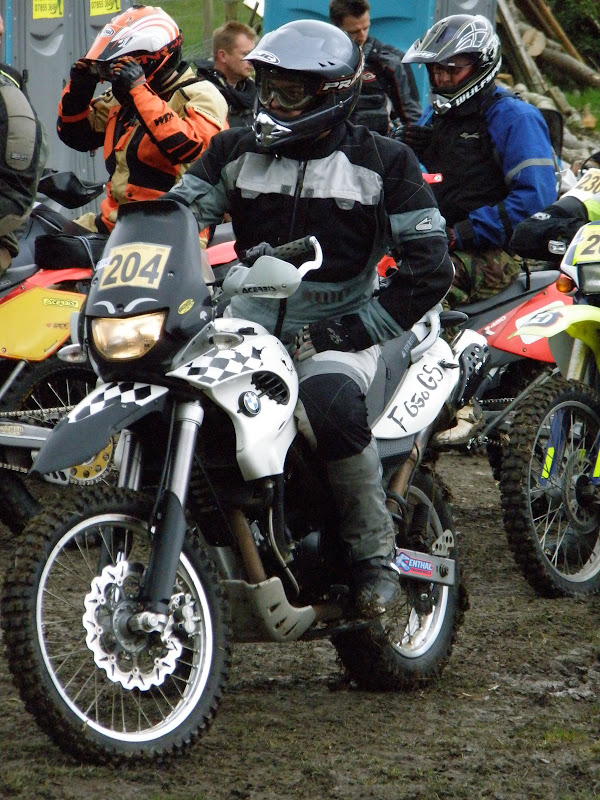

I have had my 2000 Dakar since 2004 and have since put on many miles. Front end is from a 2005 KTM 950S adventure (4860) with 245mm travel. Rear strut is a Wilbers. Still fettling with the system to get it just right.
Start Line
While being built
And here it is flying and bottoming
