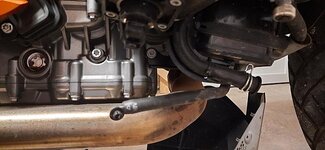

Replacing the original silencer/cat today, I took of the sump guard and the tank covers.
Under the right tank cover there is a lose pipe with air written on it.
Does it just "float" about or should it be plugged into something?
Edit:
Doh. Look and Yee shall find. Plugs into the tank "protector"
