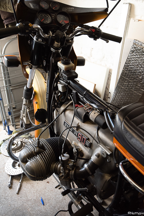

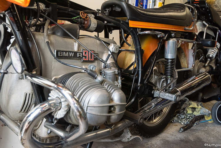

So I have started a “big” clean – which will take me months as I intend to strip the Bike to clean each external part separately, replacing any bits that I am unhappy with............I just want to document the work just for something to do, for a few hours a day - (sad really, as my wife would say!!) - so it's a deep clean first before I get on to any other stuff
The Bike has not been run since 2007 - so may I need to get the carbs cleaned - (any recommends?)
Here’s a few photos of the Bike

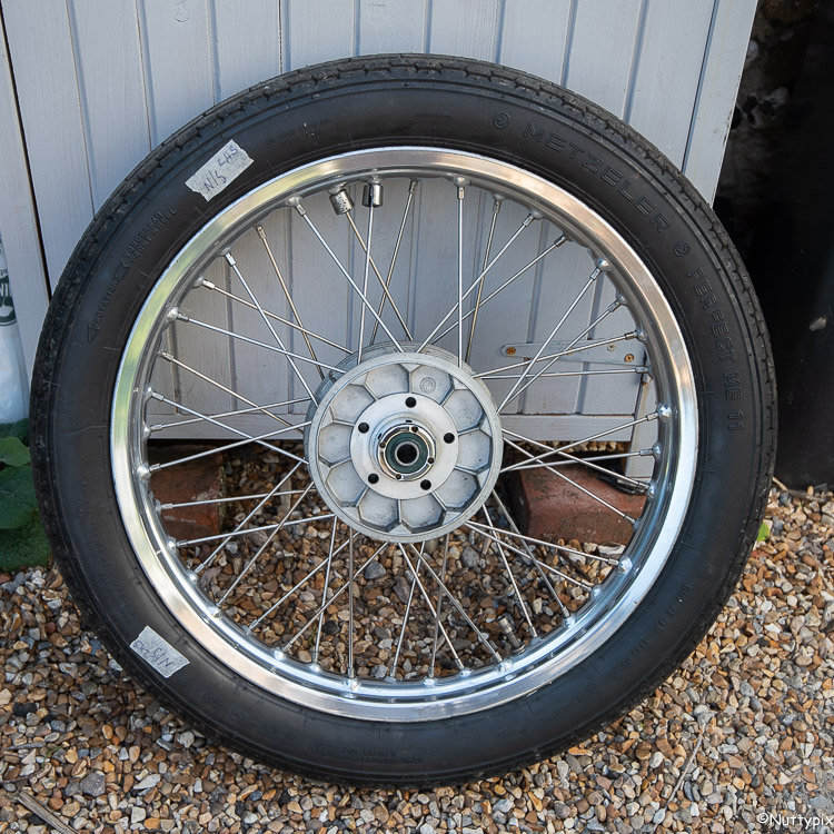

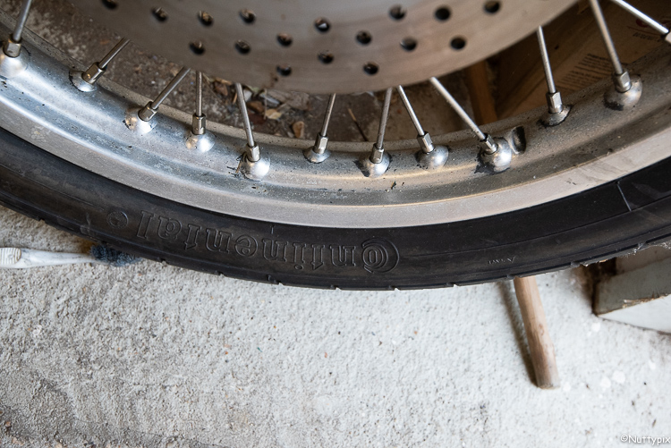

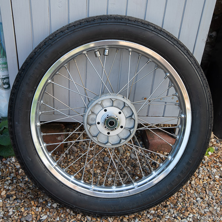

after 2 hours + the front wheel is coming up like new using autosolve and a little petrol to remove the yellow stuff. I still have to clean the hub and disk carriers

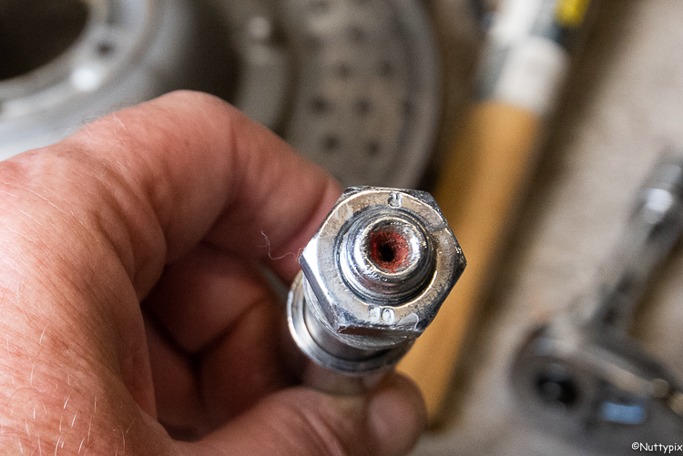

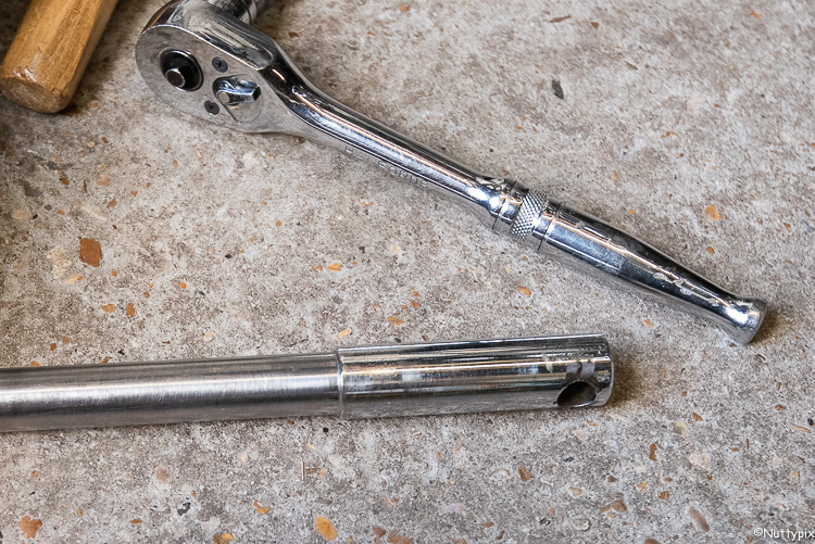

what is quite disappointing is that one end of the wheel spindle and nut on the other end is chrome plated and the chrome has started to peel off.
All the alloy stuff is fine.

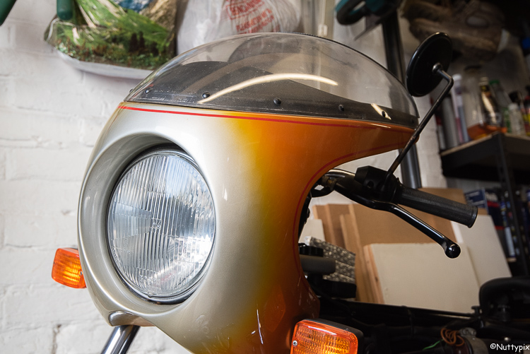

The paint has peeled off the mirror stems and some of the script on the switches has faded - oh and the R90S badge on the rear mudguard has fallen off - glue has given up the ghost!

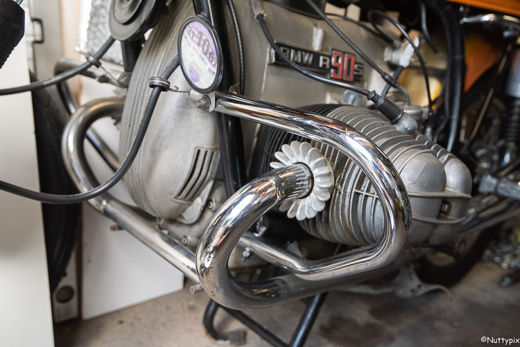

What are you guys using to clean the Alloy casing? – I usually mess around with petrol and alloy wheel cleaner testing small areas first.

Treat yourself to an Ultrasonic cleaning bath/fluid for those carbs - it will soon pay for itself. Maybe some rebuild kits too; see how it goes.
Various options for the casings if you want to take them back to original as new condition. However most media will require you to strip back to the bare cases, which would seem inappropriate in this case given the originality of the bike. OK, degrease them with something like Jizer, but take great care with alloy wheel cleaner - horrible stuff; it can leave streaks & stains if it is allowed to dry.

Thanks - yep I do take care - generally I scrub them first with soapy water, (good car wash stuff), then loosen the dirt with petrol and the old tooth brush, then wipe and straight back into the bucket of soapy water - then repeat......... a jet spray dose no harm plus an air gun
I hate working on a dirty bike or car - even just to change the oil - before I get into anything mechanical the Bike has to be very clean
Pity about the tyres - they were new but 15 years ago

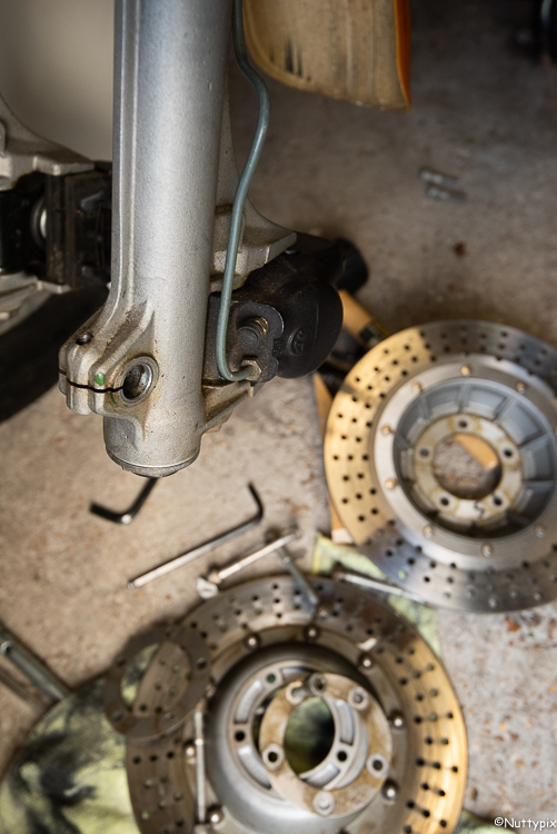

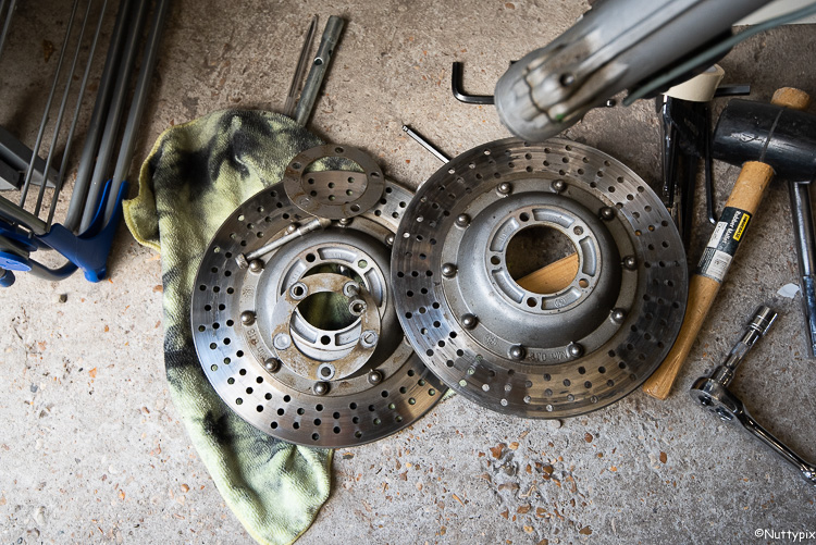

just finished the disks and disk carriers - don't like the look of the bolts they are just "dirty" and won't clean up - so over night in some de-geaser

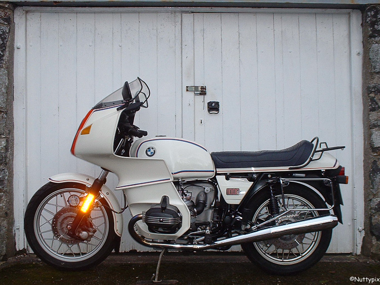

R100RS Motorsport. My favourite BMW. Do you have the white panniers ?
I've owned two motorsports, funnily enough owned them both at the same time.. bloke in Dorset bought one and my neighboiur made me an offer i couldn't refuse on the better one.
Hi Neil - I have the period white panniers, but they are the normal ones sprayed white - new seen any in solid white plastic
Its a TJJXXT reg number and I have seen a few T reg with those first three letters - I wonder if most were sold by one dealer
