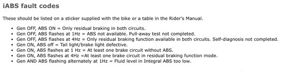

Recently I had the warning triangle showing, but a new bulb solved that. I was out today and the warning triangle came on after braking heavily together with the ABS light rapidly flashing, I stopped and turned off and started ok with no lights on, then after braking the same again, stopped again and turned off and on …… this time I just used the back brake and all ok until I used the front brake, then ABS rapidly flashing again.

Thanks Ian, I would say it’s either numbers 5 or 6 on the list …… ABS flashing quickly ?
