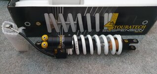

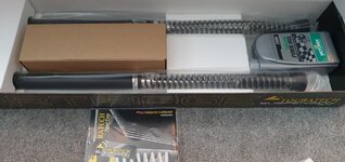

Well it's arrived today, God knows when I'll get the chance to fit it :confused:

Mmm! They do look nice, don`t they?

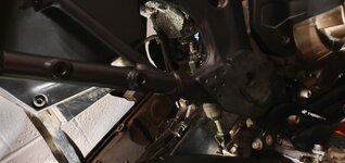

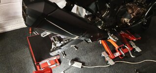

Got the rear shock fitted yesterday myself.
Wasn't too difficult, but had to remove the rectifier (which is very easy anyways).
Just rotate the shock around and wiggle it free from underneath the swingarm (which needs to be raised and wiggled up and down also). Took about 5 to 7 minutes to wiggle it free.

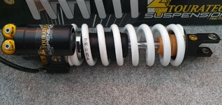

Bit more Gold Bling added to the bike...
What's nice is it's a much slimmer unit, so will be really easy to remove and service. Won't take long at all.
