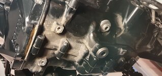

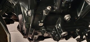

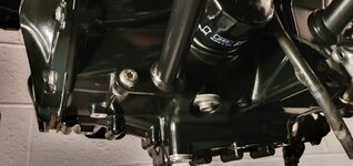

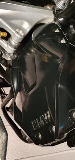

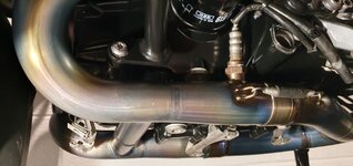

Headers turned up today, so without delay I stripped the bike and installed them.
Being as I've just done it's 18000 mile service, I gave it a good clean underneath as well, once the skid plate had been removed.

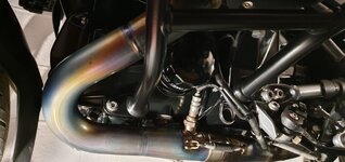

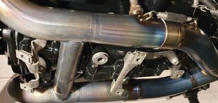

Then fitted the headers

I took off the original BMW Headers, including the flappy valve thing, and the cables, and the servo motor.
Replacing all that lot with just the Akrapovic Titanium Headers and a Servo Buddy (to plug into the cables and keep the bikes ECU happy).
The Original Headers weighed 3.3kg
The Titanium Headers and servo motor Weighed 1.6kg
So an overall weight saving of 1.7kg (pretty much half the weight).
Just got to wait for the powder coated parts to come back now to finish it off :thumby:
