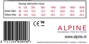

Not sure why Apline were vague on attenuation information because the attenuation is shown on the packaging, the higher rated yellow filter has an SNR of 20.78. :nenau
Hmm, maybe different packaging exists, mine has no SNR and I called the supplier and he couldn't find it on his stock either.
There's no SNR explicitly displayed but there is this...
I did simplify my given SNR as its not exactly a straight MEAN average of the average attenuation values but the SNR is approximately what I gave.
