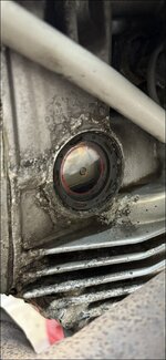

2. While it’s all down I need to spray the crankcases under the cylinders. The area around the oil sight glass is a bit of a mess as below
Is replacing this a case of levering/removing the old one out and pushing the new one in with a new spring clip? I planned on cleaning the cruddy paint off with a brass brush, then removing the sight glass before spraying up the crankcase and replacing it. My only concern with this is what impact having paint on the mating surface might have on the resultant seal. Obviously I’d try and minimise this though.

I’d do the paint work with the old sight glass in place, since it won’t matter how much is gets damaged/painted. Then replace it afterwards - small wood screw in the side and lever it out with a claw hammer, then tap the new one into place.

I’d thought the same Paul! Just didn’t want to ‘tear’ the edge of my lovely new paint getting the old one out.
I’m also uncertain as to where I drill/screw it. I’m assuming it’s straight through the glass iniine with one of the holes on the backing plate, rather than the rubber as I don’t want to damage where it seats.

I use a seal puller to remove sight glasses,
They can be plastic or glass depending on how old it is - smash it, insert puller and lever out.

Id be leaving the old one, masking off, clean paint and respray, remove masking and ride off .. 😉 looks fine and I've only replaced one when I've had to...
I’ve always removed telelever bolts over the years as you’ve described - long handled socket bar in the left bolt with it wedged against the cylinder and undone the righthand bolt .
