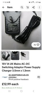

Do you use the same charger for both. I had an antigravity charger fail. I replaced with a good after market one and all is good again.
I initially thought the jump pack had failed.
This is the original charger which AG used to include.
Newer types use USB C
