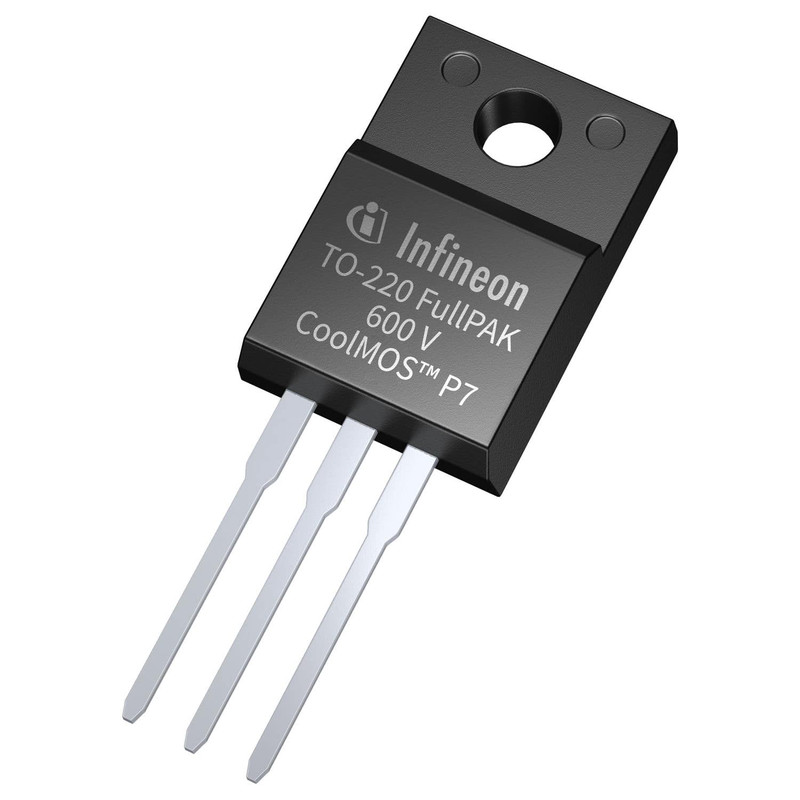

Does it have any Mossfets on it?
I know they have a tendency to 'pop' if the load gets too much. Cheap and easy to replace (if you can solder) and they're easy to test with a multimeter.
