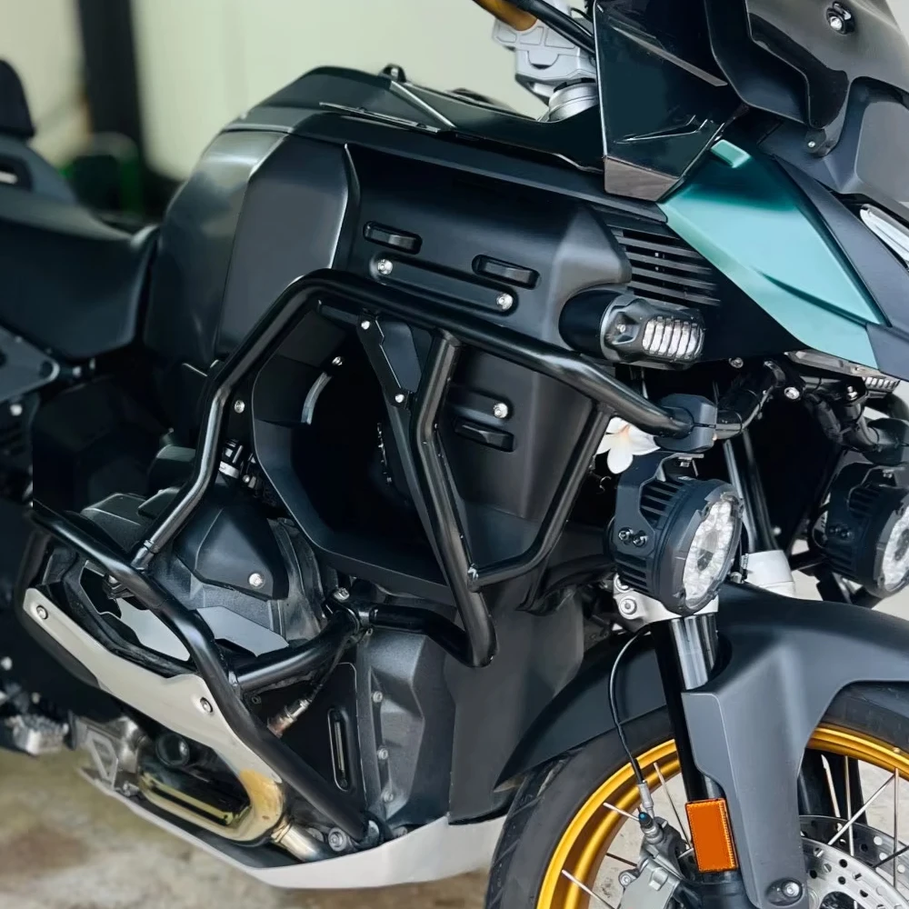

After wasting time and money trying to find an aftermarket option to replace this silver (air filter?) panel to a black one, I am considering spraying it myself.
I have no idea if it’s possible, with a rattle can at home, or what the technique would be (etching primer first?). If you have done it or know what to do then I would appreciate your advice?

I have done it a few weeks ago with a quality Matt black rattle can and it looks factory 👍👍 very easy to do 👌
Super, did you spray straight on to the panel or did you have to prep it (other than an alcohol wipe)? Also, can you recommend the product of paint?
I used panel wipe to make sure really clean, then sprayed with no primer. About 3 coats with around 20 mins between coats. 👍

I asked for a quote for the silver panels on a gs1300, these are smaller than the gsa panels an was quoted £180, my paint can was about £12 and did the gs and now also the gsa 👍
