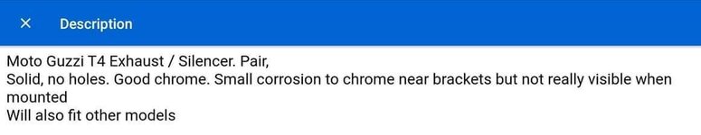

The silencers on the Guzzi Strada are u/s.
Stainless replacements are circa £350 - £450, even chrome are that sort of price.
So I've been on the look out for a used set.
My phone pings Sunday am as a set came up on eBay, for £120.
SITO replacement chrome silencers ( now owned by Leo Vance ) came off a T4.
Bought them straight away.
Little bit of corrosion on the back near the mounts, but I can treat that & touch up with galvanized paint.
As it's on the back it's not visible..
But in sound condition.
Arrived this morning.
Luckily Guzzi used so many parts across the range of 950 / 1000 cc bikes over many years, that were the same.
Silencers for the main were ethier flat or upswept & the same size.
Using the same 42mm bore.
So easily interchangable..
Well pleased..

Been watching Guzz silencers on eBay since February & it's the first set that's come up 4 sale...
So well pleased & just goes to show if you put a watch on items your after on eBay, you can get lucky.....
