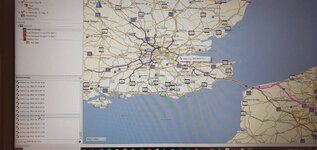

Looking through my recent logs,I can see a nice little route I took. I now want to convert it into Route. But there doesn't appear to be a right-click menu offering this or any other menu?
Does anyone know if it's possible to convert an Activity Log into a Route?

Gents. Thank you very much for the input.
There seems to be some semantics here and I'm not sure how important it is?
I'm describing the journey I want to convert as an 'Activity Log' - because that's what I'm viewing (see screen shot below). I see these logs by clicking onto the 'internal storage' icon listed directly under my 595 in Basecamp. There's a list of the logs and the journeys appear as grey lines on the map.
Are these also recognised as 'Tracks'? If yes, then I can use your instructions
These logs seem to record where you go, regardless of whether you're following a planned route or not using the Zumo unit (but yes, it would have to be switched on during your journey).

yes the blackish greyish line with the arrow heads is a track, if you were to right click on any of the active logs (tracks) once highlighted in the left pane you can then use the instruction convert to route. hope this helps.
Magic! Thank you very much for that. I'm going to get onto it this evening!

Wapping. Thank you for that video. Sorted it last night. As you say, a really useful skill to have. I've even created a route from a track - now that understand the Activity Log entries are seen as Tracks - adjusted it and then added some bits. Worked a treat.
