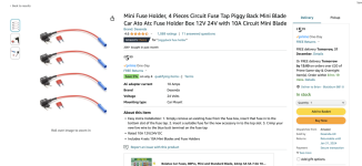

"A question for those who use this box or similar. Where have you connected the trigger (ignition) wire to?"
I used a piggyback setup as below and used the horn fuse in the fuse box to tap into. Just to save me cutting into the bike loom wiring.
I like that idea compared to cutting into the wiring loom. Where did you get those?
As above....
I just bought off Amazon. It's the standard size you require.
