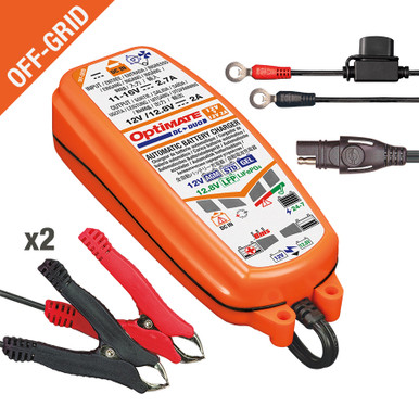

If you are going for just a battery or simple power station, keep in mind that DC to DC chargers do exist, and you do not waste the power inverting from 12 to 220 to then get back to 12 again.
Optimate sells them and so does ctek.
