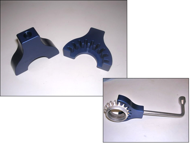

Too big to carry so considering alternatives - going to see if I can make something i can attach to a tyre lever (big 'un shoved up frame spine), but in interim, who does the best one for garage use nowerdays?
My motorworks one seems to do the job, probably similar to the motobins one. Have you seen the one made by Henderson in the states http://www.hendersenprecision.com/indian_moto/bmw_products.html
or this one on eblag http://www.ebay.co.uk/itm/BMW-R69S-...05?pt=UK_Motorcycle_Parts&hash=item2ebefad7d1
I dont think it looks quite as robust as the henderson one
