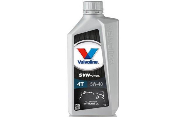

Same spec as BM oil for RT WC
Same spec as BM oil for RT LC
