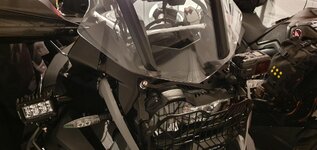

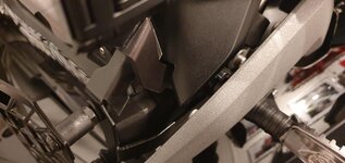

On the R1200GS Adventure there is a little clear plastic 'window' air deflector behind the windscreen... accompanied by another two black plastic air deflectors each side.
It's a real pain in the ass to clean, as it's usually hidden away and covered in crap... but you can still see it through the windscreen, :blast
Anyways, on the new R1250 they changed it to a single piece unit, all black, no crappy clear plastic nonsense.... and it retro-fits to the R1200

So after fitment on my R1200..... that dirty crappy window is gone......
Just nice and clean and tidy now. :thumb
Easy to fit. No need to remove windscreen. Bolts straight on. :bow

If you've got a Touratech headlight guard (like mine in the picture) you may have to cut a small 1cm gap into the plastic cockpit cover, to allow the fixing arm enough wiggle room and space to fit. I just filed away a small section which isn't noticeable at all.
