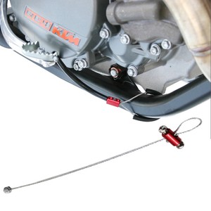

Personally I would keep the old steel oem pedal and put a short, sturdy 'brake snake', back to that crashbar mount and that would be more (just as) effective, maybe

Try a 'brake snake'
Maybe one of these will help
https://www.ebay.co.uk/itm/BRAKE-SN...AMAHA-KAWASAKI-SUZUKI-HONDA-KTM-/162753025698
