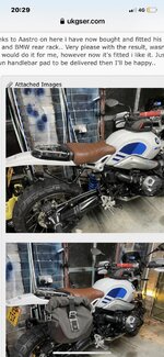

Like this Rob?
No fella ive got this rack but dont know if it will fit with the rear mudguard
Would need to have a look at how its fitted to confirm but the initial look suggests it won't fit? If you can take a photo with the seat removed that would help?
