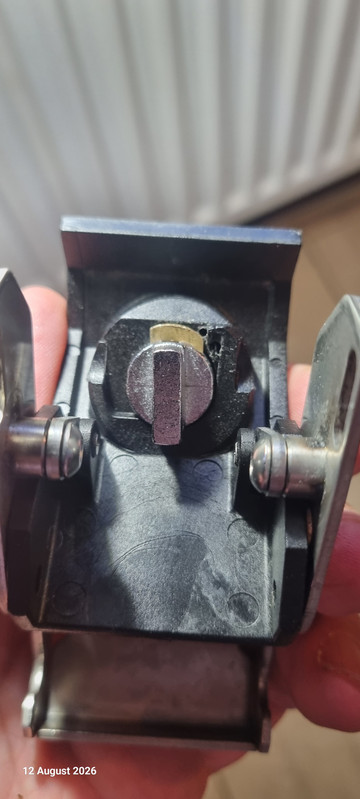

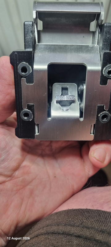

Me LoneRider topbox decided to spit the lock out ,luckily I managed to find most of the wafers and springs.Quick message to Nick Marshall(top man,thanks again Nick)and he kindly dispatched 4 springs(which was more than I asked for but just aswell, as the LoneRider springs are longer,2 entwined did the job as 1)

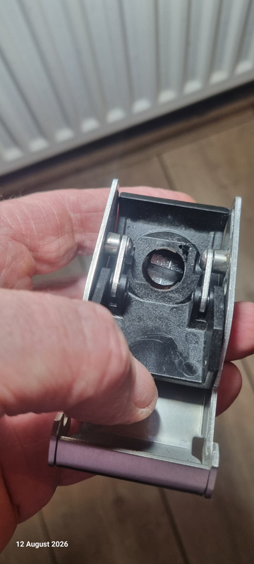

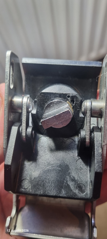

Reassembled and recoaded to my key,put back together and the feckin thing fell out again.After taking it apart,I could see the barrel spinning and depressing the sprung loaded end wafer, causing the barrel to come out.Bugger.

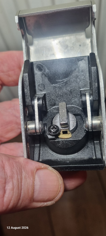

After a bit of head scratching,I drilled a small hole and tried a watch strap spring(bloody handy to have a box of these in various sizes)but no good this time, nail but same result,the wafer kept depressing as it went round.
Tried a tiny screw,perfect fit and done the job.
The lock is firmer/tighter than before.
Love a bodge,even better when it's cost nothing but a kind gesture from a forum member,what it's all really about.

Does the lock wafer only insert one way? Just wondering why it has a square profile on one side and a ramp shape on the other.
Good job, very satisfying when a little job like that works out.
Yes,the wafer only goes in one way(it's spring loaded)As you say,bit strange how one side is rounded,allowing it to pass the plastic ramp.I had a really good look under a magnifying glass,and nothing looked amiss or broken,it was all clean.Maybe it was worn on that side(I don't know the history of the box)
