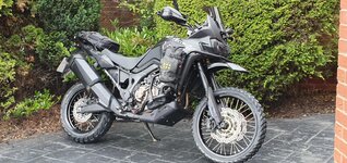

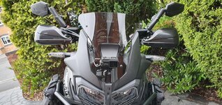

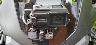

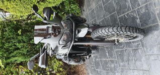

I've got a really nice and slick Garmin Virb XE Camera setup on my BMW R1200GSA (front and rear) permanently wired in.
Both these camera's have 128GB memory cards and can run continuously for 10.5 hours each. That's a long days ride, and plenty to cover every single second of it.
If nothing exciting happens, I just reformat the memory cards before the next rideout. So they're always ready to go, and fresh. No worrying about batteries being charged etc etc.
All waterproof, so just get on your bike and ride.
Anyways.... done the same thing now to my HAT. :thumb2:thumb2:thumb2
I needed locations that were not going to be 'in the way' when the bike crashes. So I don't want to be picking up bits of camera kit every time it falls over.
FRONT CAMERA
