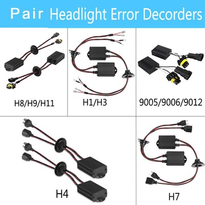

Adopt Load Resistor & Capacitor Anti Flicker Error Canceller, fixes error code or fast flickering issues related to the low current draw when using LED bulbs upgrading the halogen bulbs
It will solve the problem of warning error code, hyper flashing and prevent error message and canbus error for most vehicles including: BMW, Volkswagen, Dodge, etc

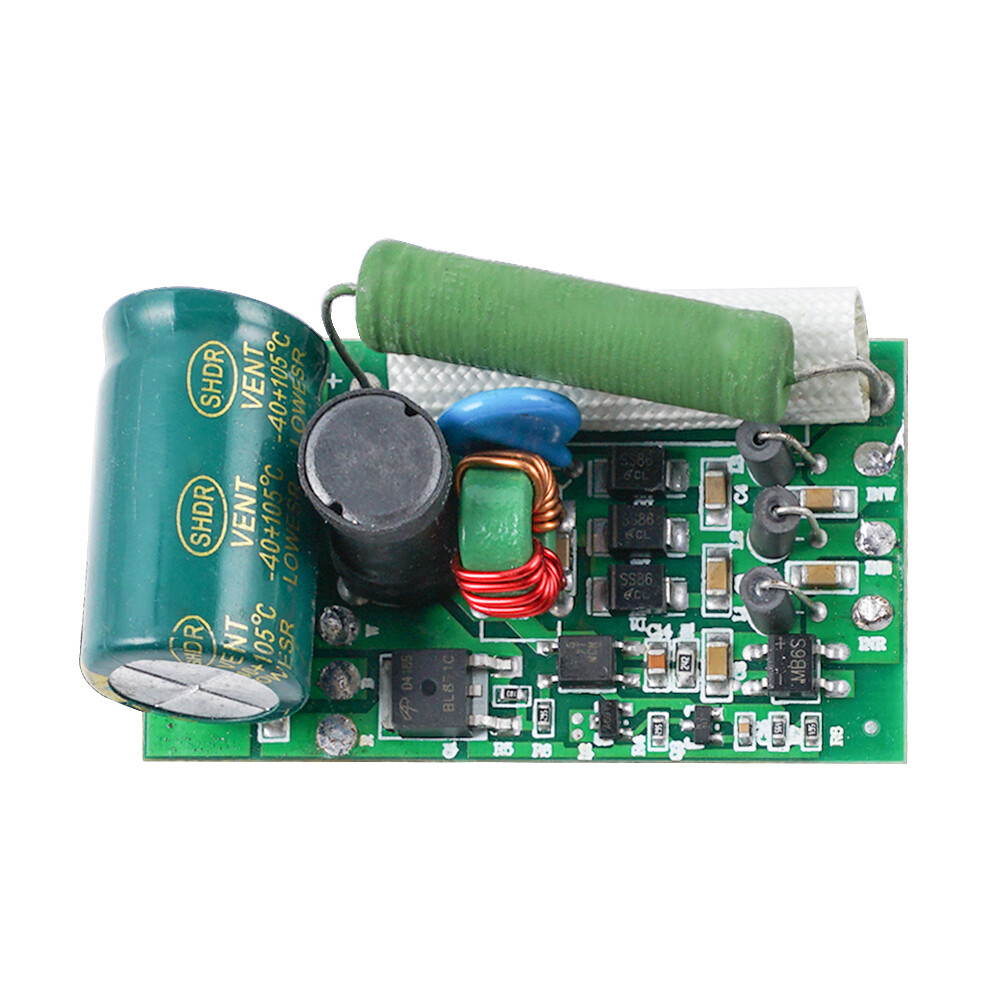

check how much rubbish the good ones have inside - as its life dependent might be worth thinking about... https://www.ebay.co.uk/itm/303926588257?
Not the cheapest, but works well.
No errors.
