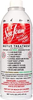

I've had good results with Seafoam over the years. Ultimately it all depends on how badly gummed up it is.
I used this following a recommendation on on here. I've a Yam WR250F which is only used infrequently, and pulling it out of the garage this year it just wouldn't start.
I bunged some seafoam in the tank, plus disconnected the fuel line and squirted in a mix of seafoam and petrol in. Left it 30min and it started, warmed it up and rode it round the lane and it was fine.
I've got an ultrasonic cleaner but I'm fairly certain that taking a carb to bits would end in tears, so I'm pleased this worked.
I bought a Honda Nighthawk 750 that had sat for a couple years and while it started and ran, it didn't run right. I tried Seafoam but it didn't help so I finally bit the bullet and took the carbs off and apart. Some jets were completely clogged shut I don't how the thing ran at all? Spritzing carb cleaner directly into the jets didn't even clear them so there was no way any fuel additive would have worked. I separated a 3" piece of old lamp cord and used the fine copper wire to floss out the jets then sprayed cleaner through just to be sure. Ran like a top after that.
