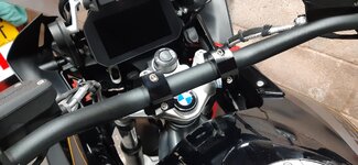

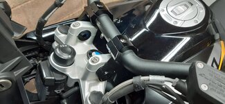

I have fitted some Chinese Rox Type Risers from Aliexpress.
The Ad states they are for the R1250GS, however they are 1 1/4 inches (31.75mm) diameter not 32mm. Never the less they do clamp up solidly and the quality is good.

Clamping up solidly is the least one should expect from handlebar mounts and I know that beauty is in the eye of the beholder… In my opinion they are fugly :barf

So you've spent how much on your bike ! And then you fit a cheap possibly substandard item to a safety critical area ( holding the handle bars to the steering mechanism) of your expensive bike. If it was me I'd stump up for a reconised brand that would give me confidence when I'm riding my bike
What he said. There are plenty of non safety critical items Chinese bits I would fit to my bike, but anything that has the potential for failing and causing my demise gets the best I can buy.
I would be interested to know how you tightened the lower clamp. The correct method is close the gap at the front then tighten the rear bolt to leave a gap. The risers however obstruct the rear bolt and therefore you cannot follow this method.
