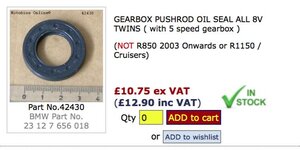

Parts from MW due in tomorrow. But looking at photos on the web - as i do a little prep before i get in there - i can see there is a seal in the gearbox itself that the push rod runs through.
Should i replace this as well, while i'm in there? And presumably that means draining the gearbox (not a big deal at all).
I mean one of these:
EDIT: Just seen this says 5 speed gearboxes... I thought all the gearboxes were 6 speed on the 1150?
