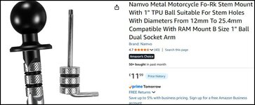

I’ve fitted a Garmin XT to the top of the dash via a simple bracket which uses adhesive and a Garmin adaptor.
From Amazon
Replaces one handlebar mount screw
Can then use a standard mount.
If you don't have speakers you can open the left hand speaker cover (couple of torx) and plenty of room for power adaptor if needed.
The spare BMW ignition powered connector is just below this so easy access to that.
Mine has tubular bars so a bit easier, but used above on my last RT and it was fine.
Other option, if possible, is Fork Stem adaptor.
