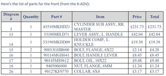

Ok.... I think I've pretty much got the left hand side brake lever sorted out.
It can be done using the Honda X-Adv kit.
Jonathan at Rugged Roads has been very helpful and helping me in the background. The only part missing at this end, is the brake hose that's long enough to reach the rear brake.

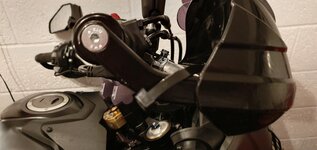

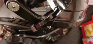

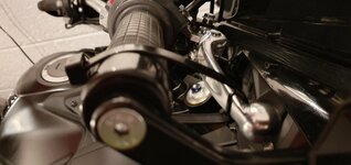

Ok here you go.
What about two cable ties.... one thick one (to be used as the main locking mechanism) and one very small one, to hold the big one to the lever.
Under normal force, it slides up and down the hand-guard rail. When needed for lockout, it needs to be pulled hard and looped over the handlebar.
As the main lockout cable tie is at an angle, it has to be manoeuvred into position, it can't accidentally flop into the locked position.
(The pictures may not be in sequence, but it shows the idea and in practice on the front brake lever)

More pics
