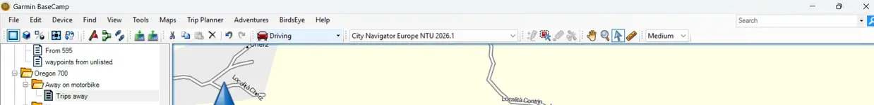

Have you selected something other than the Global Map in the ribbon at the top? I have City Nav NTU 2026.1 in mine below:
