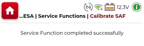

Will see if there is any errorsView attachment 525793

On center stand.
Need to do it with both wheels off the floor during the whole calibration service. Where it extends both shocks out to full length.
It says it on the GS-911 with the calibration setting.
I must have missed that bit 😁
I will do it again tonight, i don't have a jack so some jiggery pokery will have to administered.
I do find it strange that i could hear and see things moving during calibration, but not when i selected Dynamic/Road/Rain/Enduro.
In the past i select either while riding, stopped or off the bike and it quickly moves no problem.
I need to take it for a spin and try after calibration really.
