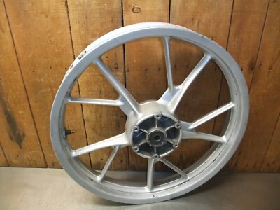

As above, needed to use to powder coat so aesthetic appearance irrelevant, but must be straight & true. My front wheel has started to shed its paintwork, would consider a pair if available.
Would F650 cast wheels (such as this) fit a 2016 F800GS Adventure? If so, is that a sensible way to lose the tubes?
The F650GS twin only has a single brake disc up front, the F800GS and GSA have twin brake discs so not an option
Additionally the wheel/tyre sizes are different , the F650 Twin is Front: 110/80-19 and Rear: 140/80-17 and the F800 is 90/90-21 for the front and 150/70-17 for the rear
A new wheel is about £750 from BMW so I think £130 for a used rim isn’t too bad , but understand if your looking for a bargain basement one , just be careful it’s not cheap for a reason
