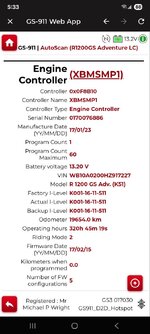

Fault error help please Bike ran fine then on the way home engine management light can on and wouldnt rev and idles up and down. Turned it off and on all was fine for a few miles and happened again. Same thing and on I went probably do it 4 times before I got home!
Plugged in the GS911 but not really any wiser
It shows 6 errors which is about the number of times I restarted
Worked it as these are the readings so throttle is faulty at a guess
“Twist‑grip channel 1 adaptation: 1599.00 %” “Twist‑grip channel 2 adaptation: 3.93 %”
If you click on the fault code, it should take you to the Hex GS 911 forum discussions on it.
Based on the above
either the throttle assy or the short connector loom
known faults which is good (or bad whichever way you look at it
Thank you for the replies and info I will get it sorted and be back riding very soon. :cool: . At least its known faults and nothing too serious as its just when we get this great weather and the damn bike plays up.
All sorted now thank you - needed a new throttle which cost me £250 inc postage! Was easy to fit and configure using my GS 911 thankfully although I wanted Ocean to do it as I could have claimed back on my warranty however earliest would of been the end of June. Perfect riding weather I didnt want to miss so decided to pay for the part and do it myself
Out of interest how come the manufacture date is 17/01/23 yet the firmware date is 17/02/15?
No idea to be honest but today before I used to calibrate the throttle it had an update so Im presuming thats the default standard software before you update them?
I was under the impression those numbers are from the bike not the 911. If that's the case your 23 bike is missing a few updates!
