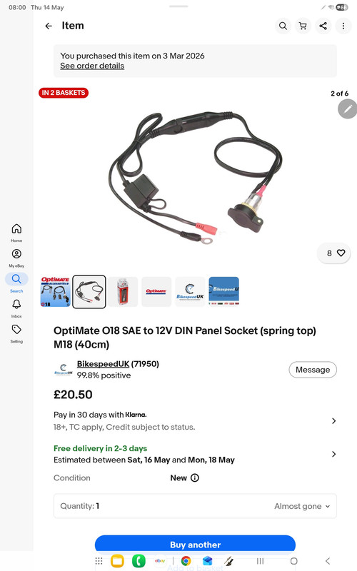

Burridge01 Well-known member UKGSer Subscriber Joined Aug 17, 2022 Messages 648 Reaction score 1,357 Location Basildon,England May 14, 2026 #5 I have this on my GS,good quality construction, I did trim the lead as I didn't need the length offered so no join. And it's fixed to the small left panel below the seat on my 1250 gsa.No issue with the Canbus,I've run me Desert Fox compressor up on it,no problem.

Wapping Well-known member Moderator Joined Oct 21, 2005 Messages 93,531 Reaction score 19,812 Location Wapping, London May 14, 2026 #6 Burridge01 said: No issue with the Canbus,I've run me Desert Fox compressor up on it,no problem. Click to expand... Given that it appears to connect directly to the battery (via a suitable fuse) that is not surprising.

Burridge01 Well-known member UKGSer Subscriber Joined Aug 17, 2022 Messages 648 Reaction score 1,357 Location Basildon,England May 14, 2026 #7 Wapping said: Given that it appears to connect directly to the battery (via a suitable fuse) that is not surprising. Click to expand... Yes,I thought I'd mention it as your ChatGP mentions the Canbus being "picky"

Wapping Well-known member Moderator Joined Oct 21, 2005 Messages 93,531 Reaction score 19,812 Location Wapping, London May 14, 2026 #8 Burridge01 said: Yes,I thought I'd mention it as your ChatGP mentions the Canbus being "picky" Click to expand... That’s what the AI has picked up and misapplied, probably based on nothing more the terrors the system holds for some on these pages. It needs to learn.
