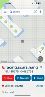

W3W gives a coordinate in any format you want, but I’m struggling why you want to make a single point into a gpx file. Just put the coordinate into your sat nav and it will take you to that point.

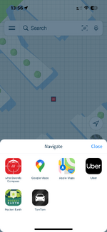

Or, from the w3w just hit navigate to open a navigation app on your phone.

The picture I posted shows how you get a coordinate in W3W. It does it in the app itself.

or you could just load the WTW app and it gives you the geo-coordinates.
Touch and hold them and they get copied to clip board. Add to BC or Excel or the like and repeat- then save file.
