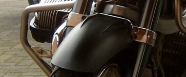

I had my fork brace polished about 5 years ago. Although I only metal polish it about every 6 months (2 minute job), it is still as shiny as the day it was first done.
Mike
As far as i can see there is not a problem with these , .Must admit yours do look good .i was to lazy to drop whell out ,just removed calipers , Thanks for photo.
