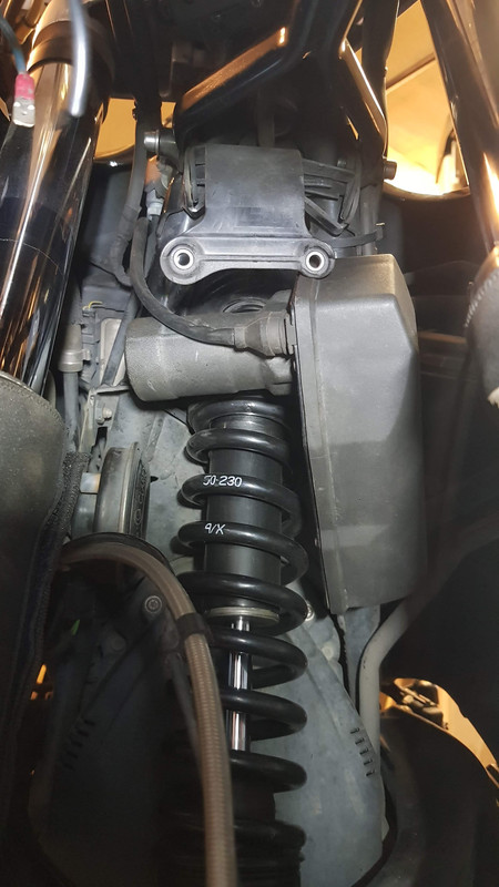

Hi guys,
I am after refurbishing and service of my ESA system on 2012 GS ADV but i came up to a somewhat idiotic problem:
I'm keeping my bike at my friends garage as i don't have my own. I took out both shocks before winter and screw all parts together a little after to don't make a mess around. Some parts i left under the bike.
And yesterday i finally put all bike together. Without the "anti twist plate" (that mount which was screwed to front shock) because my friend put it somewhere and doesn't remember where 😥
I installed both shocks on the bike but front ESA motor can be twisted. I tried to find everywhere some spare parts to that, but i can't.
Is it possible to substitute/replace it with any other holder? How necessery is that mount?
I can't sometimes with how easiest parts can be the most difficult 🤣
Now it looks like that on the bike:
That bracket is supporting the ESA gubbins (probably shouldn't use that word as I think English may not be your first language :D ) and you really dont want it flapping about and worse case interfering with suspension travel.
There are 5 mounting points fixed with screws (marked 8), three on one side and two on the other. Actually the two top ones are nut and bolt.
I guess at a push you could fabricate a similar bracket to hold it in position. Good luck.
The shock in the OP`s photo is the later 2012 esa unit which is different to the earlier shock in this parts picture.
Apologies @Ridix and thanks @Mistacat for correction.
I figured it was probably the same and too lazy to check which just goes to prove be careful what you learn from randomers on the internet. I feel duly obliged to go off and find correct pic :LOL:
And that was my fail 🤣
Guys literally You can call me drama queen or something like that.
After few months of not seeing parts i checked scheme first before re-installation and saw this metal mount (marked red by landmarkjohn). And i thought i messed up baadly as i couldn't find it. Yesterday i drove again to garage and took a peacefull examination of whole front. And, what a surprise 🤣
In my ESA version, the hole unit is hold only by this plastic mount (marked green above), and it fits by 2 little screws directly to shock from above.
There is no extra fitting at all.
I feel myself stupid, but it was a lesson.
Thank so much to:
landmarkjohn
and
Mistacat
for help and pointing it out.​
