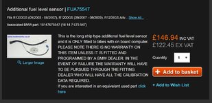

I would replace it using one from Motorworks, although when mine failed (2010 bike, failed in 2017) I got it replaced by the dealer so that I'd have the 2yr warranty. If you fit it yourself, no warranty.... I did dismantle mine to see what was wrong and found a black spot on the strip - could not see a way to repair it reliably.
It is not that hard to fit and the GS911 has a calibrate function and procedure. I had to take the tank off, but simple enough.
My labour bill at the dealer was reduced a bit because there was a warranty recall for cracks in the fuel pump connector bosses and they replaced the fuel pump left and right (GSA).
Here's a link to some photos I took at the time... exactly 2 years ago it failed, on 10th June!
https://goo.gl/photos/AEbxhqze16k8U1Zm8

i think though I'll have a stab at fitting a new one from Motorworks i want to get rid of the dash warning light
Thanks Bin Ridin for the info and photos :thumb Its more the calibration i am concerned with, It cant be simple as my local dealer took about 5 attempts and 2 strips before they fixed it the last time.
That is interesting about the piezo-electric fix, I thought about it but I decided that it would really annoy me to have to fix it again if it failed again.... so I spent the money.
I think you can find info on the GS911 site. I think it is important to calibrate the strip DRY first. Handle the thing with great care, I would not be surprised if half of them are f##ked while being installed.
Mine worked for 6 years in Saudi Arabia and lasted 18 months in Ireland. I think ethanol may have something to do with it.
Definitely connect up the new one outside the tank before inserting or immersing, then hit the calibrate button....
