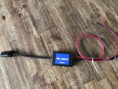

Something seems to be going on, on this dodgy website he's selling a bit of stuff to save the repin job, but he has two different units
a GSA one at 92 euros and a GS one at 127 with the more expensive one seeming to have two other wires to play / connect up, with I guess somehow doing what the other 2 of the 4 need...
https://translate.google.com/translate?sl=auto&tl=en&u=https://www.proebeemer.nl/producten/
the actual site in funny money https://www.proebeemer.nl/producten/
