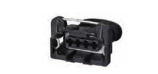

is there any where you can get the connectors to build a test lead ?
I think the 4 way connector from here should fit (can't be sure though)
http://www.vehicle-wiring-products.eu/VWP-onlinestore/connectors/housings.php
Make sure you buy the terminals to go in the connector too.
