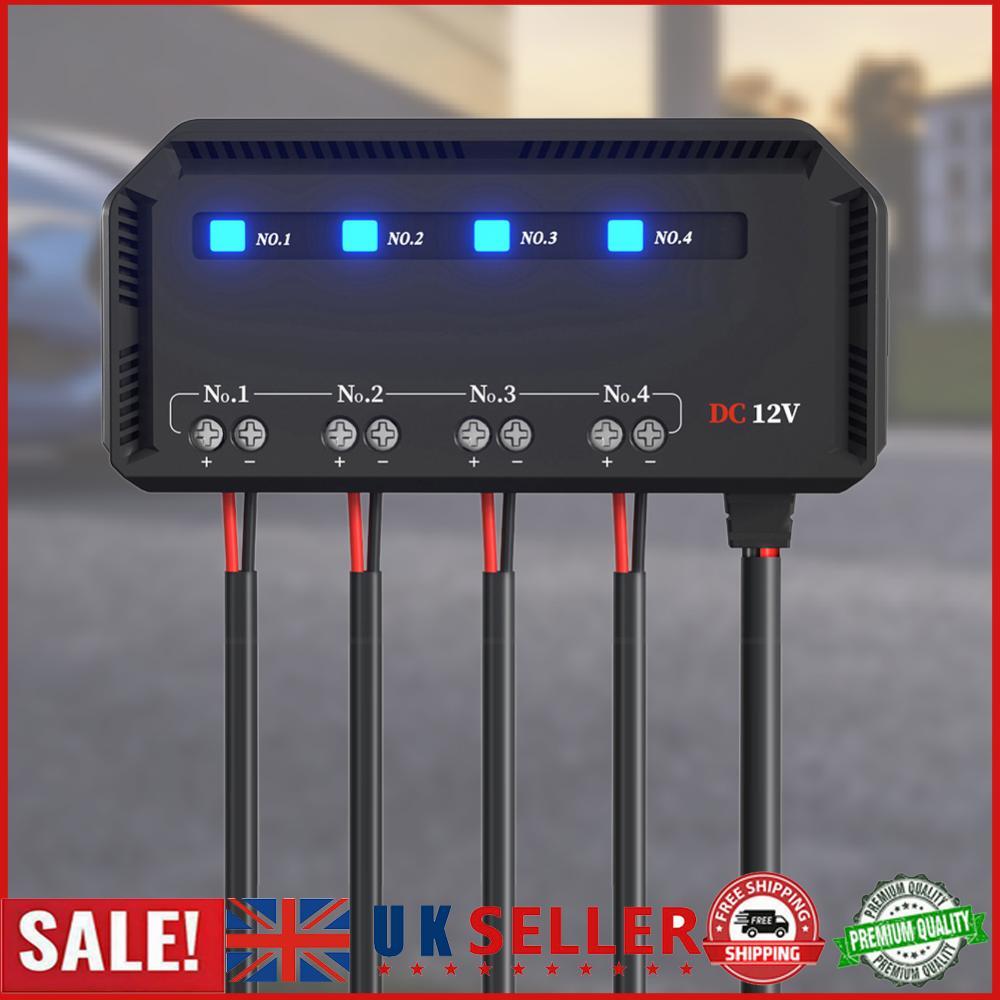

If they are plugged into the Oxford fusebox then yes you can remove the others
Basically you just plug pos and neg of each device into this (max 5 amp per slot) and it will turn them on and off for you. Normally will be a delay when starting/turning off
In theory they don't even need separate fuses as its fused to 5 amp per slot but don't hurt if they already have them
Looks exactly the same as the Oxford one, but for £13.36 - I have one of these Ebay ones, works fine.

Do the Oxford ones allow you to chose either switched live or non switched live?
