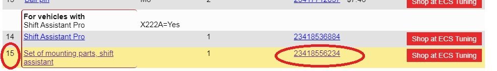

Coming home the bike got stuck in 3rd and the gear lever went floppy (insert pun here).
On inspection there is a small cage that goes around the spline for the gear selector. It has broken.
Does any know what the part is called?
Found the part I need:
23418556234
Now to find somewhere that sells it.
Thanks. I have ordered the part through the dealer in Northampton, my local BMW dealer don't seem to want to answer the phone. Looks like it is German stock so will be a few days.
