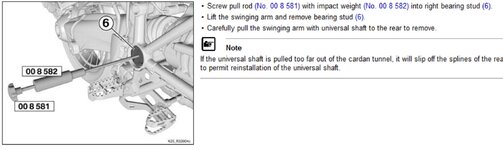

Onwards and upwards! Next stop trying to get the swing arm pivots out. Hopefully I can get the right hand one out without a slide hammer.

That went much easier than I thought it would!
The pivot pins came out easily with no need for a slide hammer on the RHS.
I took the swingarm off and pulled the old boot off. It was definitely knackered.
I popped the driveshaft off with a big screwdriver. No issue at all! I guess strictly there was no need to do this as I could have just slid the old boot off and new boot on, but I read it is worth greasing the driveshaft splines.
