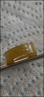

Definitely worth stripping and cleaning as the oil had a silvery sheen from the failed bearings. Discovered the nylon detent roller has seized on its shaft and had a flat worn into it..
Now cleaned and rebuilt, waiting to go back in..

Still trying to source a smooth gearbox case to rebuild this into, but just received a shifter mechanism refurb kit from Motobins.
A good kit in my view as it contains all the springs, clips needed for a rebuild, plus a bearing to replace the nylon detent roller.
Started work on the output shaft. Pics to follow
