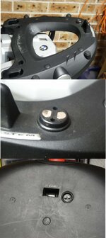

This issue has been solved and shouldn't be a problem.
See the thread entitled "Givi Top Box stop lights" at http://www.ukgser.com/forums/showthread.php?s=&threadid=35398
Someone has also managed to get them working without the relay simply by using the jumper connection directly into the stop lights. This is worth a try before hooking up a relay.
swebb said:
I note your concerns about the wiring, i didn't realise it had impact on the ABS... guess i'll be using the reflective bit only, and not wiring the brake lights in then !!
See my previous post on how to wire the lights.
Here are pictures of the connector between the Givi box and the circuit.
On the Givi rack, there is a two pin connector which makes contact with the connector on the bottom of the Givi box. Givi provide a pastic cap for the connector for when you don't have the box fitted, or you can just cover it with tape.
I know that some riders consider this box too large, but I have been using a Maxia (or equivalent) for many years on my K1200RS, R1150GS, and now the R1200GS without problems.
I have ridden in all weathers including strong cross winds. Trying out the R1200GS top speed, it indicated 225 kph with BMW panniers and the Givi top box and I didn't have any handling problems.

Thanks Vampire... i like the idea of the lights working, so if they're not too difficult to wire in... me thinks i'll be having a go :)
cheers for pics.... paints a thousand words etc...
