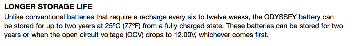

why anyone thinks charging in the garage is necessary is beyond me anyway :confused:
Thanks for this. It looks like I won't have to bother charging it for some time anyway!
