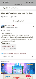

When I read the original blog, I’m convinced it said 850/900. So maybe it’s worth another look and check.
Thanks, I did find that but it’s for an 850 Sport - I’m sure a lot of the figures are the same but I don’t want to risk it
